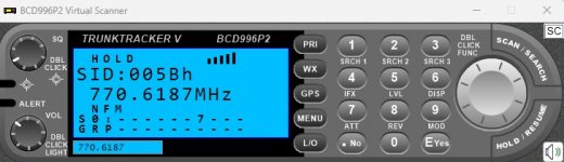

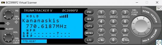

4791
Jul 23, 2025
5
YYC
It's a different site number. I'll check to see what that is....
(SID:005Bh)
So, I only see some full site I.D numbers. I've no ideas why, or what I, doing wrong?
Crossfield I can see the full Site I.D.
I think I have found the issue, Olds and Kananaskis have the same Control Frequency (771.3312)
So I'm picking Olds, NOT Kananaskis.
