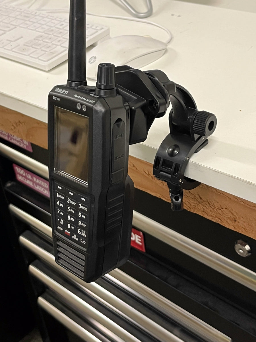

Has anybody messed around with mounting a whistler 1040 in a vehicle? Or just a holder of some sort for the scanner?
I have a customer who is looking to have a place to put the scanner in his truck but have it still be removable so he can carry it if he needs to.
That's what cupholders are for. My SDS100 and G5 work great with that mount.
