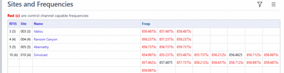

In the favorites list, there are also these other sites included.

I also would set those sites farther from your area, like Abernathy, to ignore, so that the scanner does not waste time trying to pick it up. Coverage for Abernathy (from the database) appears to be very marginal for your city:

I will try some of these other settings like you mentioned such as the "wide normal" setting, NAC to ignore and removing the abernathy tower. I also might remove the Idalou and Ransom Canyon towers also, and just leave the simulcast site.

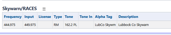

While our periods where we often have severe weather is usually the spring, when that comes around, you might want to include the Skywarn net for Lubbock. You can program it, but not monitoring full time by setting the channel (or the Department that it is in) to Avoid, then clear the Avoid when there is severe weather in, or approaching, your area. Or, program it, but don't enable the Ham service until there is a weather event in progress. (You can toggle that Service type on or off in the Service Types screen in the scanner's menu.
toddf

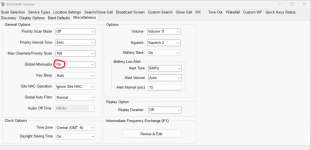

Ok thanks I will add the Skywarn. One thing that is very interesting. In my sentinel profile I set the global attenuator to ON. It has made a huge differerence, I am getting most everything that are in my favorites. Not sure exactly how the setting is helping, but it is like night and day now.
