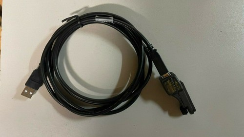

I got one of those yellow routers, and that was very easy to set up and the radio sees the router and connects to it. But I still don't see it via discovery over wi-fi in RPM2 which causes me to ask again, for the third time, if it is possible for the radio to be configured so that it will not appear over wifi by software selection?
Please answer that question with a yes or no answer. Not looking for anything but that one answer to that one question.
No, my programming cable still has not arrived, in fact the order hasn't even been confirmed and I placed it two weeks ago. I am less than happy about that. But that's not a matter for this topic's discussion.
These are in stock with fast shipping. I have one and know the guy who makes them. Very Halal.
