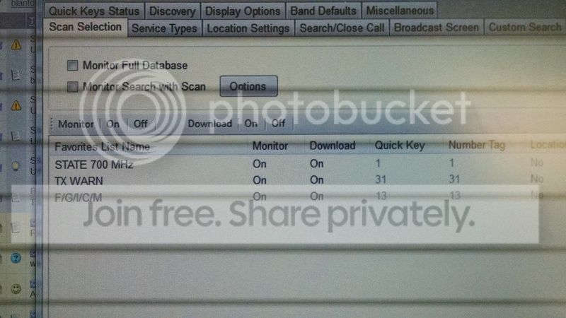

When I bring up the edit profile screen in sentinal and I have enabled all the favorites list quck keys I want and if the monitor and download options are set to "yes" and if one of those systems was pulled from the database do I need to check the box that says "monitor full database" or can I leave it unchecked if all those other setting I mention are turned on?
Tim-B
Nov 17, 2016
531
77
Down South
I guess what I am asking is if my settings are as in the picture below and the quick keys are set to on then is this all I need to set to "on" to be able to monitor these systems or do I need to check "monitor full database" as well. I programmed two of the systems myself but the TX WARN system I pulled from the database but I did do some heavy duty editing of it then I save it and the profile anew.

You do not need to monitor the full database if all the things you want to monitor are in Favorites Lists (that are set for Download and Monitor, and whose quick keys are enabled).
