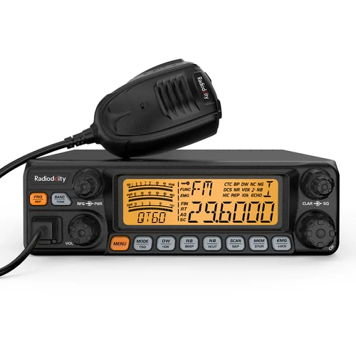

My preference in mobile is a separate amp. Despite increased difficulty of installation, one can more easily change components. Not “trapped”.
The better question is AM-only, or AM-SSB, as the latter has more features and is generally more capable. (AM only with amp is sorta useless: ability is key).
RF power can be varied to suit. I use an LPF from the Amp, and a BPF from the TRX to Amp. Coax filters at far ends.
Clarity is what matters. A modern NRC radio gets thru the forest better than what came previously. The “crutch” of power (in a big truck) is thereby ameliorated.
A dual final radio in a passenger vehicle or on a base is overall sufficient. In which case a QT60 is ideal for either. Time and attention to the antenna system is what actually matters.

Order this from Mike (with conversion and alignment ck) and the thread question is settled. DSP precedes power as a fundamental once AM/SSB is the minimum.

NMO34b + WD640 whip, permanent mount on roof center (research, has been discussed).
