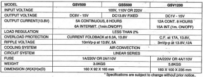

According to the specs, the GSV500 is rated for 5 amps continuous and 6 amps intermittent.
@yahya How much current are you pulling from your GSV500?
