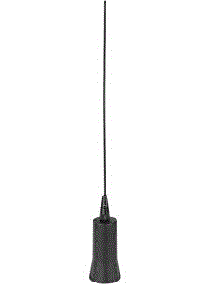

anyway I'm going to buy the NMO27 asap ..... is this the one I want ( I want the all black one)... but I want to make sure to get the right one.....
I get free shipping on Amazon so if I can get the whip with it for free shipping I'll go that route...
so before I order one mmckenna is this the NMO27 you like? Amazon NMO27 say's Larsen STRINGS??? I want to make sure I don't get a knock off.
thank you in advance.

That looks correct. I'm wary of random Amazon sellers, though.
$58 at Digikey:
$59 at Arcadian:

thank you.... I tried to order from Arcadian.. but you have to buy a minimum of 9 units..... ...I just need one.
on Digikey it only say's pulse... most of the ones I look at say Larsen on the top, on one side and NMO 27 on the top of the other side
again thank you
