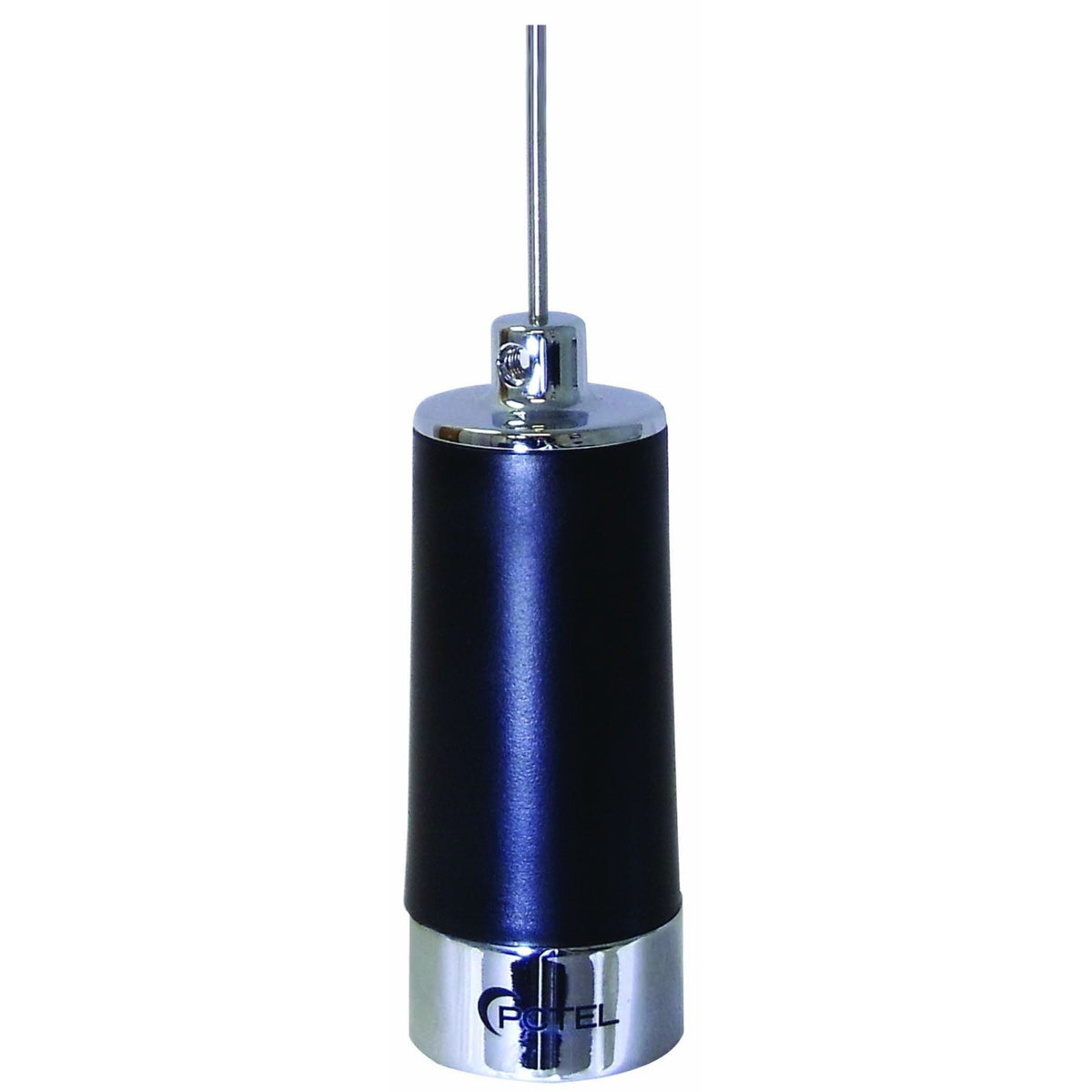

Larsen nmo 30, Larsen spring & 64” whip trimmed for CB the overall length is 62.5”. Built in McKinley Swr shows 1.0 across the band. Mcbazel external meter shows 1.1 on channel 1 & 1.2 on 40.
RX is definitely improved over the pctel cb antenna it replaced. Skip on 37 is coming in good and I can receive one noaa station now. Quality is much better on the Larsen components as well. The pctel base coil came apart while I was removing it.
I’m not sure if the rx improvement is height or quality but I’ll take it either way.
