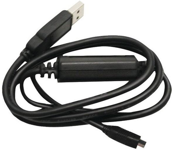

what about the 436 ?
Yes it works with a 436 but instead of using the DB9 connector you have to use a Prolific USB cable which connects to the GPS port on the side of the 436 scanner. I have such a cable but can't remember from where I purchased it. Will do some research and post the results here if successful.
Nari59
Jan 6, 2012
5
2
Sydney, NSW
This is the cable I use to connect the 436 to ProScan on my PC. Originally purchased a while ago to connect my UBCD369XT scanner.
