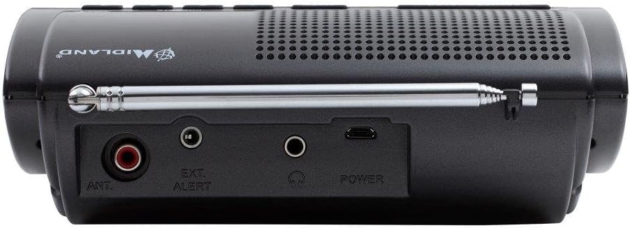

Is it possible to broadcast over a cable? The Midland WR400 WX radio has an RCA jack for an external antenna which would be perfect for receiving the signal that way.
If not, is there appropriate equipment for making a micro VHF rebroadcast that only needs to travel a few feet or less?
3. Another idea. The WR400 has an output jack for an external alarm:
I could put a WR400 on the hill and use its external alarm function to trigger a rebroadcast over a WX frequency so that another WR400 in the house could monitor silently until it picks up that rebroadcast. Although the rebroadcast would be over WX, it would literally only happen during an emergency and even then it could be low power and directional since it only needs to travel ~1300 feet to one house with no other structures or public roads anywhere nearby.
How are you connecting your roof mounted antenna to the Midland receiver now from the 75 ohm coax? Are you not using the RCA port?
