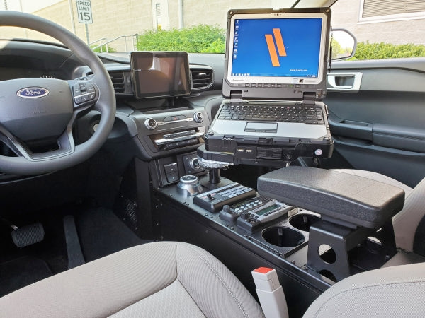

Unfortunately there is NO Console model regardless of brand made for a 2024 Ford Explorer "Consumer Model" non Police Interceptor.
weathermedic
Mar 13, 2008
127
68
NYC
How about this? The 2020 and 2024 should be virtually identical.
