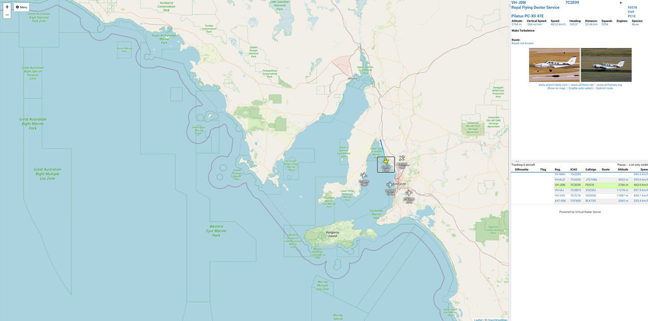

G'day Brains trust.
I bought a flightaware ADS-B dongle. Their software apparently has to run via PI and thats too hard.
Im looking to get a program to run locally on my pc that shows my data on a map.
So i can have that running on the second monitor and see whats coming and going.
SDR# and similar allow you to upload to their software for the world to see.
Im not wanting to do that. I just want it for me here.
Currently i have a screen that shows the data, but not a map of such
Ive tried planeplotter. The graphics on that looked like a commodore 64.
Basically looking for a program like flightaware, but only on my local pc.
Appreciate any help you can give me.
Gordz
Mar 17, 2025
5
Never mind. I found Virtual radar. If anyone is interested its quite good free software.
Its just on your pc. view via browser, but locally, not via web.

Basically i did the same. Virtual Radar is good. 200 km of coverage in all directions. You should see a post prior to this one onecer mods let it through. Full screen view of what i ended up with.
Im still not sure on the pi. Alot of linux work. Plus i need it on a pc screen. 7 inch Pi screen wont do much for me lol way too small. Through the pi its sending out as well. I want to keep it local on my system. Dont like the idea of advertising an open port for no reason. Cheers for answering. Appreciate your time
