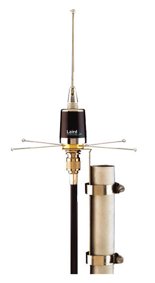

Hoping someone can help me with this. I have a 20 foot fiberglass flagpole attached to my camper. I am looking for an idea for a simple antenna to attach to the flagpole and then hook it up to my HomePatrol scanner.
Any ideas that would work? I lower the flag pole when I leave and also have a solar light on top of the flagpole.

So, you want something light and reasonable size.
If it was me, I'd get this antenna:
I've used that on my work truck and it's a good antenna.
And I'd get this base station adapter to provide the necessary groundplane:

Make sure you secure the coax cable near the top. You don't want the weight of the cable pulling constantly on the antenna base.
