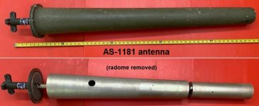

AS-1181/UR VHF AIRPORT ANTENNA WITH RADOME FREQUENCY 100-156 MHz RATED for 100 watts Description AS-1181/UR IS A VHF RADOME ENCLOSED SINGLE ELEMENT VERTICALLY POLARIZED HALF WAVE DIPOLE ANTENNA THAT COVERS 100 TO 156 MHZ. THAT IS MOUNTED ON A 1.25 INCH DIAMETER PIPE BY MEANS A BUILT IN CLAMP. THE POWER RATING IS 100 WATTS, THE CONNECTOR IS A TYPE HN. OVERALL LENGTH: 58 INCHES, DIAMETER: 8 INCHES AT THE BOTTOM, NET WEIGHT 14 LB.Screenshot (19).pngwanted -AS-1181_UR -small.jpg
(Text and photos taken off the internet)
