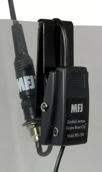

I use one of these stuck to the top of the window as high as I can get it Workman Scan4 Scanner Antenna SC1
They used to make one on scannermaster with a BNC female mount on the end so you could put whatever HT antenna you wanted on but they went out of production just as I went to buy one. I was surprised though when it actually picks up pretty good, I like to do business band monitoring and can hear the little 2 watt itinerant HTs quite a ways out. It's even better when you're on the 2nd floor of the apartment building or higher, I've also taken it to use in hotels and public library seating that overlooked a shopping center before.
I've used that for various applications as well as the old "Window Clip/Over the Window"
altho most of mine are the original Radio Shack Version it allows me to hang them on the Wire-Rack that my scanners sit on.
With a Dual-Band Antenna, I've got reception for quite a distance (YMMV) and you may need to experiment with the antenna bands
