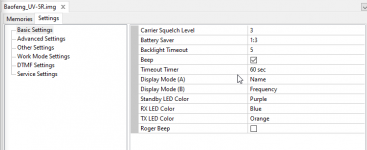

Edit: attaching the radio's IMG from CHIRP as well for reference.

Check the roger tone selection on the uv5r; it may have MDC1200 enabled or just the ANI set for end of transmission.
