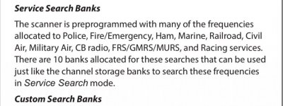

@CB62, I think you will enjoy the BC125AT if you decide to purchase. There’s tons of stuff to listen to still in our area. It’s a nice little scanner.
I am a bit west of you (Central Massachusetts) and am fortunate >95% of local agencies are still analog conventional. I have some Boston frequencies programmed in (MBTA Police for example) and pick them up fine.
The Uniden programming software is not too difficult to use and you can program in your frequencies and assign to banks anyway you choose.
Out of the box (with no programming) you can scan by service type to pick up activity.
