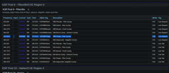

Will the BCD160DN decode digital DMR and NXDN? i guess i'm confused some because DMR Conventional is still digital correct? for example would it be able to decode THIS ? Thanks
Yes it can, however it does not have the Trunk tracking capacity.

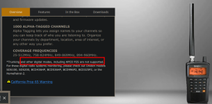

IMPORTANT NOTE: The BCD160DN will NOT trunk track so I'm hoping for your sake that said "digital frequencies" are P25, DMR and/or NXDN conventional
will the bcd160dn decode This DMR i want to buy one but i need to listen to that dmr i know it's not a trunking system but i'm unsure if the scanner will decode that . any help anyone?
Yes, it'll decode conventional networked DMR just fine. As I mentioned when you quoted me It cannot do MotoTRBO trunked (it'll decode voice channels if programmed conventionally but won't be able to follow the conversation)
Conventional ≠ trunked

Doesn't handle, track, decode, nor support APCO/P25. Trunking nor conventional...
