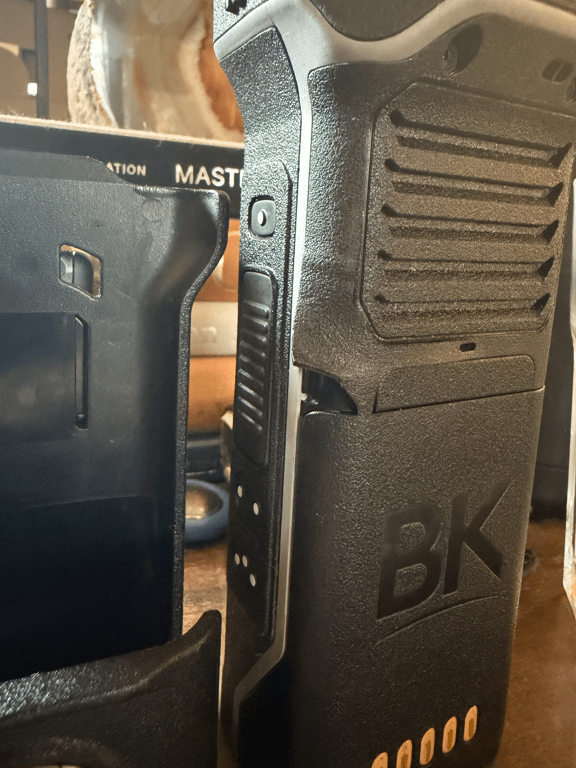

I can add in an issue I have started to have regarding the rubber casing, it seems to have started to break when using the provided holster. Reached out to my dealer this week about it, we will see what they say.

BK replaced my speaker front under warranty for that peeling issue.
My new one is starting but I think I may put a small slit in the corner to make it flush so it doesn’t peel.
