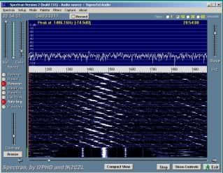

Well, I still can't make much sense out of it. Here's what I got tonight between 0730 and 0800z good signal ranging between S6 to S9+. I plotted the audio on SpectraVue. Radio set to 6836kHz USB. I was doubtful whether the drift was my rx or the soundcard drifting so the straight vertical line at the bottom is the carrier of WWVH offset by 1500Hz which as you can see is dead straight. As you see the 'tones' are a whole series of decreasing tones about 700Hz apart and then just strengthened in the area of 1500Hz - so at any one instant what you hear is the loudest tone decreasing in frequency which then pops up again only 700Hz higher. This is not the same signal that I heard previously although I didn't have my laptop handy to plot the spectrum then. It's unfortunate that at the moment I captured the screen that there were no tones showing in the spectrum - usually they were quite visible.
