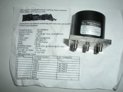

You might do better with something like this designed for high frequencies. This is a coaxial relay with four inputs and one output. It needs 28V continuously then a 5v signal to select the port and you can remote the switch anywhere and have a little box with a four position switch and 5v power supply at your radio to select the antenna. These are surplus for $24 and you can't even get a cheap CB switch for that cheap. This is just one of many similar solutions and the new prices are in the hundreds of $$.
You have wonderful feedlines from your antennas to the house, why would you throw a wrench in it by going to RG-6? Keep it all 50 ohm then use short jumpers with SMA to the coaxial relay then SMA to BNC to your radio.

Ok, I will check out the RCT switch in the link, thanks.
I did not think I was throwing a wrench in my setup as there are many comments on here about a short run 4-5ft of RG-6 and 75 ohm would not affect anything much at all?
I will check out the Diawa gear too, thanks.
