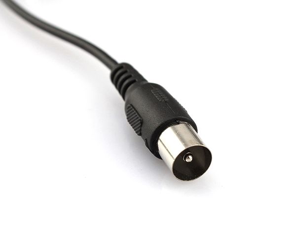

I am looking for an antenna for my RTL SDR but I can not find out which kind of connector is needed.
I have spent two days trying to find our what type of connector this is and I haven't had any luck.
Antenna cable's Male End:
8_zpse8f86183.jpg~original
RTL Female End:
83d9b68f-f10a-4ce4-ab03-de53454b131f_zps698b20f6.jpg~original
Can anyone tell me which type of connector my RTL stick uses?
And does anyone have any links to somewhere I can learn to identify connector types?

PAL. Standard on European devices. Adapters available cheap just about everywhere.. Or you can replace it with something more standard if you're handy with a soldering iron

Thank you for the fast answer!
Finding that connector type has been eating at me all day.
Where would I find a female SMA (or coax) plug that I could swap out with my existing PAL one?
Or would I be better of using an adapter?
