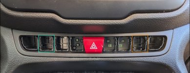

I bought an FTM-500D for my Nissan Frontier; still in the process of installing it but I think I'm going to be happy with it. Wife is going through the study materials now and we're looking at which Yaesu mobile to put in her Jeep Renegade for her to use once she's licensed, with an aim for using C4FM's GPS features for location while out four wheeling, camping, hiking, etc. Unfortunately there isn't a lot of room in her Jeep in order to do a truly clean install, I expect I'm going to have to put a separated head here in one of these three variants (aqua, orange, or purple):
For what it's worth I've already disassembled this part of the dashboard and done some investigating on how a remote-mounted head could be installed.

I know that sometimes there is no alternative, but I'd avoid mounting the radio down low like that. Looking at it means taking your eyes off the road and that's not always a good thing, especially when going off road. I don't like to do it on the highway either, but I live in SoCal where a moment's inattention to the road can be fatal.
Unfortunately there's no real choice, the position of the HVAC vents on top of the dash like that means anything mounted above would be too, high, and the lower edge of the vents are too close to the top edge of the infotainment radio.
For what it's worth I'm doing something different in my Frontier.
If I go with the FTM-300D I'm likely going to use this disassembled switch panel that is nearly all blanks in order to mount through to a bracket behind the dash.
These are the two places I could reasonably place a screw through, either into the radio head mounting boss or into the clone of the YSK-7800 bracket that the head can snap into:
Likely if I go with the FTM-300D I'll install a 6P6C jack (RJ-12) into one of the slots that isn't blocked by the head itself, so if I mount the head on the left (aqua) then I'd mount the hadnmic jack on the right.

After some further disassembly of the Jeep I think I'm just going to go with another FTM-500D after all.
I had time to test if the hazard switch in that spot (purple in the earlier post) and I was able to confirm that it is just a momentary, it's not a CANBUS trigger. I plan to install a hazard switch somewhere else, most likely in that gap between the two HVAC vents above the radio. Relocated thus the ham radio can go right over the current spot, centered.
So this is what the dash looks like without the hazard switch panel:
When I install the now-empty switch panel, it lines up like this:
the dash structure/frame is behind two sets of open switch panels.
The YSK-7800 superimposed on that gives this view:
So if I drive fasteners in through the the two innermost green open holes where switches should go, those fasteners can attach to the dash structure/frame. This will hold the bracket on tightly. if I need to use nuts on the back of the dash structure I can access them through the open cavity while I have the infotainment system out.
Bracket position without the annotations:
And radio head held up to give an idea of position:
Thanks for the input, it did help with the decision even if I didn't end up going with the FTM-300D. The speaker and handmic jack are just too useful.
