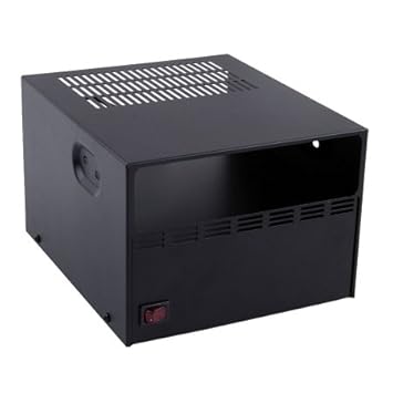

It'll work just fine.
Make sure you have enough vertical space for all your radios, consider that you might add more down the road. That might require more vertical space, or an additional console.
Make sure you figure in the cost of the radio specific face plates.
Another option that might be about the same price would be to get a short 19" equipment enclosure. These are very common for professional audio, telecommunications, etc. They are very common in dispatch centers and equipment rooms. Find one you like and get some 19" rack mount shelves. You can mount your radios to the shelf, or there are shops that will make custom face plates. It'll give you more horizontal space, allowing 2 radios to be mounted side by side. It is also a much more common size and a lot of professional gear will mount in a 19" rack.
If you are not hurting for space, go with a 19" rack, much more flexible.

Unfortunately for right now i don't have enough space for the 19" racks, I've seen lots of those and they look really clean. I got this idea after buying a Astron power supply like the one in the link below. I like how it protects the radio, so i'm wanting something like that to where i can stack the 2 radios and scanner.
