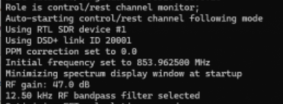

I use the following two lines of bat code to start my radio and tune the known strong signal. The output below is what I am getting from it. It doesn't seem to be loading the frequency and trying to tune it. Can anyone point out what might be wrong with my code? Thanks!
START FMP24 -rc -i1 -o20001 -P0.0 -f853.9625 -_2 -g47 -b12.5
START DSDPlus -r1 -e -T -E -Pwav -i20001 -O NUL -_1

What role is DSDPlus configured as? It looks like you have a control channel monitor with no voice follower.

The FMP24 console output indicates that it has tuned to 853.9625. I recommed removing the -_2 option in the FMP24 command while you debug this so that the spectral display is not minimized (or manually maximize the window). This should allow you to visually see what FMP24 is doing.

Sites always have at least two frequencies designated as control channels (Motorola); some sites can use any site frequency as a control channel (L3Harris and others). I am assuming that you have verified 853.9625 is the current / active control channel.
Looks like this is the Honor site, correct?
Also noting that you are not applying any ppm correction and are using a significant amount of gain. Most sdrs require some ppm adjustment, and too much gain can be a bad thing.

This has worked with this frequency and no Parts correction for several years.... DUHHHHH... I JUST got it working! I had inserted a LNA with a strong filter in it for decoding Russian weather satellites and it seems it had totally knocked out this strong signal! Impressed by the strength of the filter! My bad - sorry to bother everyone. Thanks for the tip on eliminating the -_2 to see the spectral display!
