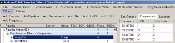

Looks like you monitoring Sam Houston Electric Cooperative Site 1 (Livingston). That looks to be the only site with confirmed data. Ignore RR data for any of the other sites at this time because none of the LCNs on the other sites are valid as 5-3-2025
In your scanner, you should have a MotoTRBO system set up with four frequencies, each with a specific LCN and Color Code
153.1175 LCN 1 Color Code 2
153.4475 LCN 2 Color Code 2
153.335 LCN 3 Color Code 2
153.5675 LCN 4 Color Code 2
That's assuming that whomever "confirmed" the site details on 4/26/2023 is correct.
You either need to make sure and add talkgroups to the scanner as well, and/or set ID SEARCH (not ID SCAN) for that system so that it will listen for any/all talkgroup and private call activity, regardless of whether you have the talkgroup programmed in.

What exactly are you having issues with? The system is in the database and @ProScan is able to download it with LCN info.
Is that not working? As of 2023 there is only one talk group listed which may not have much activity. Since the last update was 2023, its advisable to set the scanner to ID Search as ID Scan will only try to scan that one programmed tg. ID Search will look at everything on the system. You could also leave the color codes set to search instead of 2 in the event they changed or are wrong. What exactly is not working?

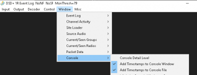

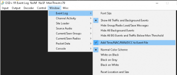

If it were me, I would delete the 1r.log file and the dsdplus.event file. Then enable the settings shown in post 4. Also post your DSDPLus freqs file and networks file. Then run the freqs again and post the log and event file.
