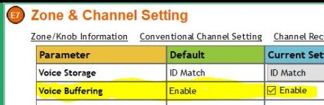

I have the pager set up the way I need it. I did not notice til now, that there is a big delay difference in the P25 received signals on the pager when the same signals come in on my APX8000. When both are stopped on the same P25 conventional channel, the APX comes in right away and the pager is like 2 seconds behind, causing an echo effect. I have this happening when I do the same test with the G3 and an XTS2500. Is there a setting to change this? The audio quality is good, it's just delayed. Obviously 2 different beasts here ( radio vs. pager ) but I was curious why this is happening.
17,725
28,107
As @wmlovell said, voice buffering. Go to the knob position (in tab E7) for each of the frequencies, NOT the knob position you have scan programmed, and look for the setting highlighted in yellow below, disable this if it is causing issues for you.

Try disabling voice buffering in the Zone settings.
Thank You both, that was in fact the problem. Now it is almost neck n neck with my APX. I have it set up the way I need it.
