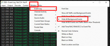

If you want to suppress these events from appearing then...
Thank you Whiskey! Background events are already hidden, Also I'd like to clarify to all I think some are confusing TG 20067 SFU PD1 with the call rejection event! It's not related, It just happened to photo bomb my capture.
