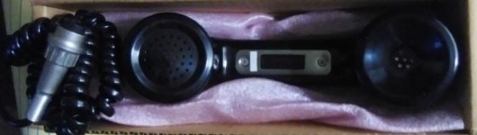

I have just the thing, though 1983 may call at any minute, wanting it back:
TMN6137A for Maxar-80. For use with TRN6319A hang-up box (not pictured).
