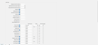

1st thing i always do on all my hytera radios is UNCHECK Call End Tone, Group End Tone and Voice End Tone.
Dont need any annoying beeps and boops after someones done talking or the group times out

Sembra buono così com'è
Hai eliminato i 3 principali fastidiosi:)
