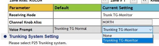

Yes I was looking at accessories......this is a fabulous radio. The only thing I need to figure out is when I change the zone knob a robot voice comes on telling me "TRUNKING MONITOR"....it is annoying cause its LOUD.....how would I disable this ?

Change it in E7, change VOICE PROMPT to none

I use it with custom voice announcements, so I don't have to look at the knob position, it is easy to pass over a knob.

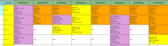

OK good one......tell me, is it a little EASIER to program one of my empty knob positions with a bunch of UHF conventional PD/FD? And that will still leave one last empty knob position....where I would like to put a bunch of UHF DMR Commercial channels?

It's all the same. I think it's one DMR system to a knob selection. That's is where you will learn about how to switch to zone 2!
For DMR the area hospitals use it for security. You have to remember you only have 450-512mhz for an conventional frequencies.

Yes I have a list of a bunch of UHF business DMR freqs and a few UHF conventional PD/FD freqs.....but these are not in any "system" they are stand alone freqs from various agencies. For example in my scanners I have a bank set up with UHF DMR freqs for RI Energy, Crown Plaza Hotel, etc.....they all come in loud and clear here. So is there a way to program them manually, putting in the color codes or tones (if PD or FD) and then program them into my last 2 knob positions? I mean the radio does support DMR and conventional UHF.......Or is this not the type of unit that works this way?

It is not all the same...pagers do not do DMR trunking. You program on frequency per knob position, I suggest you throw a couple of zones in and skip one between your conventional frequency zones and the main zone.
Then in ZONE 1 you can set up a scanning system with a max of 16 frequencies, however, I repeat, the pager is not a scanner and it scans slow. I if you have 16 frequencies in a scan list it will be slow.
