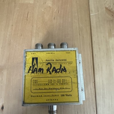

Do you have any good recommendations for a triplexer? Also looking at this to go between both scanners.
Motorola, Panorama or Sti-Co would be my choices. I have several of each I picked up on flea bay cheap. You just have to catch one early if it has a good price.
Here are some examples of what the usually go for. I usually wait until the get down to about $75.
This will do what you want, I have these and they work fine. I would recommend buying this immediately after you read this cuz it won’t last now that I posted it.
Edit: just noticed it’s an auction, offer $50 to get something started.

That SP-1300 has a pretty significant insertion loss as expected since you are not only dividing the signal, but the power as well. At least half signal power loss. With a low noise CATV drop amp, you can avoid insertion loss and overcome some feed line loss with the small amount of gain that the drop amp provides. Always use amplifiers as close as possible to the antenna in the feed line.

The SP1300 was going to be inserted in the scanner that needs to reach out farther and the 2nd output was for the local one.
