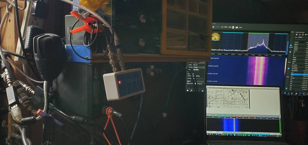

I used to run a v4 for HF monitoring. You can get good reception with one if you add a few things. An improved antenna is the most important thing, and it doesn't have to cost a lot. Check out the wiki on HF antennas and loops for some ideas.
I found that I needed an LNA, AM & FM BCB filters, and a set of inline attenuators to get the best performance from the v4. That went with a 400' helical loop antenna, but not sure what your space limitations might be. An active antenna like @PDXh0b0 mentioned will give you excellent performance for its size.
Give the v4 a try with an active loop, it might do what you need, and at least you have an effective antenna for a different receiver. Or, if you have some space, get creative with some wire.
