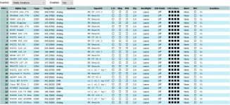

I am using the EZ-Scan. I downloaded HAM channels and grouped them but some of them are missing channels.
I click on 'New Channel' and then choose 'conventional' but I am not sure what else to insert aside from the frequency.
Can someone walk me through?
Current list:
Trying to add missing ones from Wake County Amateur Radio Repeaters

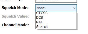

Assuming they are conventional channels, you click on Conventional then NEW after the pop up box you enter if it is Analog/P25, or DMR. or NXDN
Then you add type of squelch, you can choose search if you don't know it
Then select mode AM/FM/NFM/AUTO, if you don't know select AUTO
Finally you select the scanlist.
