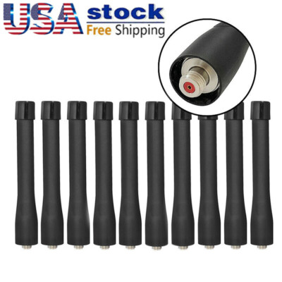

Do you have a source for an oem stubby? Everyone I see is out of stock.

An actual OEM stubby is no longer available for 403-470 MHz. There are plenty of T-Band OEM stubbies. You would have to go after-market or find a dealer/reseller that has an OEM Stubby in stock.
The eBay reseller that is in Rowland Heights, CA has been a great source for the discontinued Motorola antennae, but they are after-market antennae. I have bought numerous antennae from him. Don't get concerned that the antenna is identified with the red dot because they don't follow the standard Motorola color codes for antennae. All of their antennae are red dots. I have never had any problems with this reseller or his products and I am very picky myself when it comes to OEM. I would rather spend the extra dollars for OEM because I won't buy cheap stuff from Pandaland because it is never a savings in the long run.

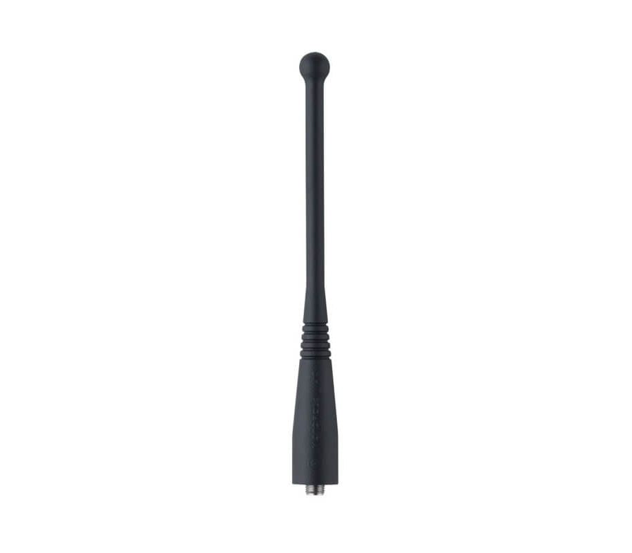

Here is a source for the OEM Flex-Whip 403-520:
I have never bought anything from Wiscomm, but it appears that they deal in the real stuff, but it appears that they are sold out because Motorola discontinued that antenna long time ago. There was never a huge call for the UHF stubby antenna.
