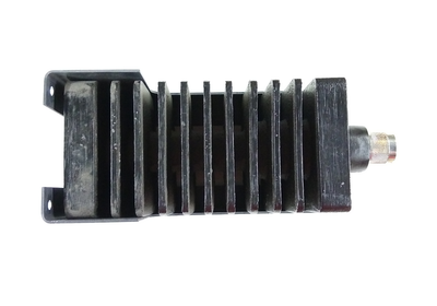

A basic watt meter and a decent 50Ω dummy load are a good investment if you expect to be working with radio a lot. I think it was some of the first test equipment I ever purchased. You don't need to buy a $400 Bird watt meter, but a decent ham radio grade meter will work. You can find used 50Ω loads on e-bay pretty cheap. Get a good name brand, not some cheap Chinese thing.

But seriously, there are some good 50Ω loads on e-bay right now.
I think I have a TX/RX brand load from a combiner system.
