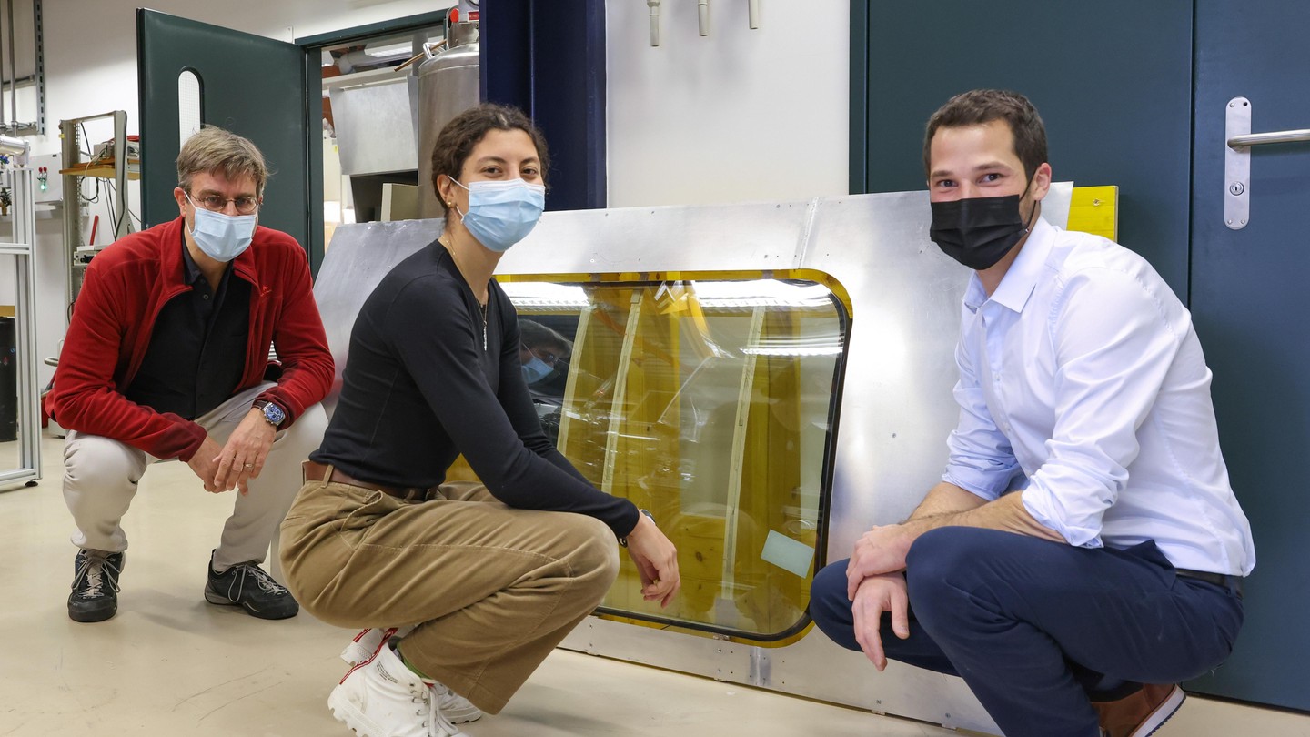

improve train Wi-Fi by laser-treating train windows?

Never heard of this, can't imagine the train windows are E glass, how many people in Finland try to avoid solar heating?
Finland has seen something of a heatwave in recent days, with temperatures edging over the 25 degree Celsius mark that tends to mark conditions regarded as properly 'hot'.
