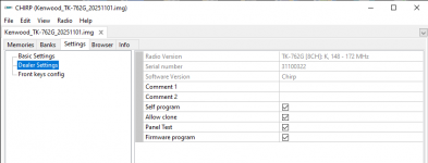

Success! You are a genius! :D
I've done as you indicated and now both CHIRP and KPG56D can communicate with the radio!
Thank you so much for all your help. I don't know who you are, but you definitely got some talent my friend. Now the radio reports as being a simple K-model in CHIRP as well, without the M variant.
I can also access "Test Mode" in KPG56D now and play with the sensitivity settings and squelch tight / open. I can't figure out how to get the continuous static removed from Wide-band channels (changing sensitivity and squelch doesn't seem to affect it), but that's another adventure... :)

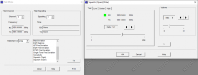

I've created a blank (new) image file in KPG56D, populated it with desired frequencies (all 8 of them, lol) and re-uploaded to the radio. It took it and works fine. This is awesome! The radio is essentially de-Frankensteinized !
Now I'll be doing some research into my static on Wide-band issue. It's as if the "Monitor" function was always activated or the squelch was set to level 0, whereas I've set it as high as 7 without any changes. I've been playing with the settings in Test Mode, but am not (yet) sure of how it all works and how to set it :

Update : Regarding the static I was getting on Wide-band channels, I was not able to tweak it in Windows very well. I tried with the DOS version of KPG56D (v2.10) and was able to raise the Squelch Tight and Squelch Open settings a bit, to the point where the "Monitor open" effect disappeared on those channels.
I know that I shouldn't be playing with those settings without specialized testing equipment to tweak the radio, but the radio was not usable on Wide-band channels, lest one didn't mind listening to open squelch all the time between radio transmissions. I'm not sure how to do a memory reset on these units, I didn't see such a setting in the software. I'll keep looking.
KPG56D v2.10 :
Here she is, finally working ! :giggle:
