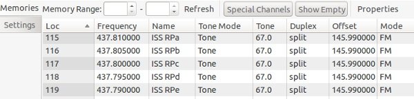

Location Name Frequency Duplex Offset Tone rToneFreq cToneFreq DtcsCode DtcsPolarity RxDtcsCode CrossMode Mode TStep Skip Power Comment URCALL RPT1CALL RPT2CALL DVCODE
20 ISS D/L 145.800000 - 1.310000 TSQL 67.0 67.0 023 NN 023 Tone->Tone FM 5.00
21 ISS+10 437.810000 split 145.99000 Tone 67.0 88.5 023 NN 023 Tone->Tone FM 5.00
22 ISS+5 437.805000 split 145.990000 Tone 67.0 88.5 023 NN 023 Tone->Tone FM 5.00
23 ISS--- 437.800000 split 145.990000 Tone 67.0 88.5 023 NN 023 Tone->Tone FM 5.00
24 ISS-5 437.795000 split 145.990000 Tone 67.0 88.5 023 NN 023 Tone->Tone FM 5.00
25 ISS-10 437.790000 split 145.99000 Tone 67.0 88.5 023 NN 023 Tone->Tone FM 5.00
NW8M
Oct 26, 2025
2
This will be easier to read...
