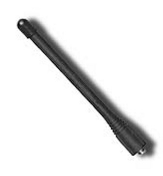

She's more use to the size of antennas that came standard on the HT1250's or this one that they were replaced with then they were damaged in the field: Motorola PMAD4042 VHF Heliflex Antenna 136-150.8 MHz and this kind (depended on the tech and yes I know this is a UHF but VHF variants of this style existed) Motorola PMAE4016A 403-520 MHz UHF Whip Antenna

The Visar VHF antenna is a good option if you can still find them, but they are frequency band specific and not super wide-band.

Yep - another vote for me for the VHF Visar antenna. I have them on all my VHF portables and they work great. Nowhere near as long as those VHF a wideband whhhhips.

Another plus for the Visar antenna for VHF. Had to go to Federal Court once. All the security in the building were using the Visar antennas on their XTS5000’s.

Yes this is exactly what I'm after. Thank you all very much! I appreciate the information, and I'm glad I asked so I didn't fry components inside of the radio.
