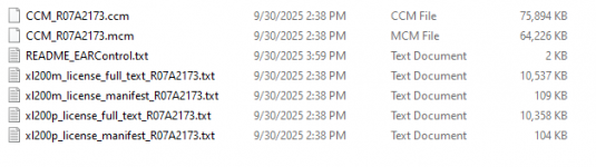

I'll echo the previous 2 comments about constantly evolving FW. I've got RPM2/XLP R22A with CCM R7A and there is a user defined RSSI roaming threshold in the Smart Roaming section. Someone I know is getting RPM2/XLP R23 with CCM R8 today for testing and this whole revision change is focused on P25T to LTE and back roaming.
BTW, R22 has P25T two tone paging and ability to disable emergency on a per system level.

I don't mean to be argumentative...but I find these version numbers suspect as hell. That would mean in the ~5 to 6 months since L3Harris officially released XLP R20A and CCM R5A (which was in April of 2025), they created essentially 2 to 3 *entire major* revisions of each firmware.

Not to mention If public availability is R20 and R05 CCM and this claim is true - it’s showing L3Harris has no strategy for firmware releases and break/fix except “throw everything at the wall and whichever sticks becomes general release” because it proves R20 is “old” but also “new”. That means they’ve essentially chained their development team to a table and said “don’t move till this is fixed” which is… a choice.

There are plenty of things I use that I doubt you've seen. RPM R15A03 ? Special release SW for converting M/P5300 900MHz OS to 900MHz P25.

To your point now though, given this chain of events, it would indicate that L3Harris really does have no strategy for firmware release timetables.

R20 is still the latest PUBLIC available XLP and RPM2 along with R05CCM, so while your "versions" are all well and great, they are not what L3 is recommending for general code on subscribers.
Even when we get a special code release for bugs or features requested in beta and not field consumption its never been 3+ versions ahead of release.

Correct. 21 and 22 is an internal release for BeOn customers and is not supposed to be in the wild. 22 *MIGHT* be released to the public, but based on what I am seeing with it, i wouldnt put money on it.
