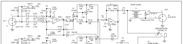

I have been looking at this specific mixer for installation in my truck so I can have audio from 4 sources, has balanced inputs and a pan function so that I can place certain receiver's audio spatially in the cabin. On the output two powered Motorola speakers.

Thanks again, that's enough for me to make a decision. Now, I just need to search for the cheapest ground loop isolator that I can find that physically keeps the input grounds isolated from each other. This way, I'm still hoping that a single stereo isolator with one scanner into the left and one scanner into the right will do the job.
Cheapest is not best. The ones you want will have a large physical transformer inside. Usually two transformers because they are for stereos, so you get the bonus of two radios. The cheap ones either have tiny transformers designed for very low levels of AC and DC or simply have a pair of capacitors blocking low frequency response.

That MX124 doesn't use galvanic transformers on its inputs, so might not be as effective to prevent groundloop issues. That C107 high pass filter are liniar, it will have an impact on 500Hz and gradually attenuate the lower it goes in frequency but will have most effect when both pan and volume are in their middle position. If either or both controls are at their end the filter effect will be almost non existing. It has a low production cost and low performance by only using transformers at its output.
