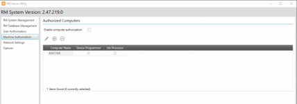

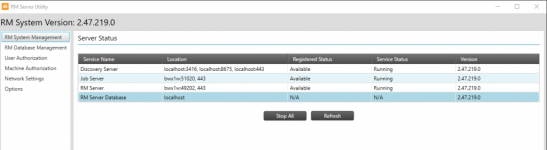

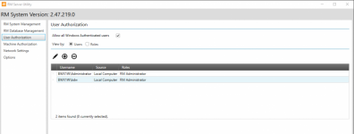

I'm afraid there are no Security or System tabs in the RM Utility tool. I've attached what I see. This is with the latest APX CPS (31.00.01). Note the screenshot showing the connection being successful is from the RM Server machine. On other computers it fails to connect.

On the "Server" use the RM Server Utility and set up the User Authorization and Machine Authorization based on how you want clients connecting - Then in the Client be sure to use the Server Name (System Name) you used in the Hosts file as the "Host".

Got it. Thanks! I figured out the issue with the connectivity between secondary Job Processors and Device Monitors. Windows Firewall was enabled and blocking connections on the RM Server. I had to manually make a rule to allow communication on the ports RM Server uses (attached, in case it helps anyone else)

Edit: to add, you don't have to set up any authentication or modify your hosts file. It works out of the box once you allow connections through the firewall. The default settings (as in the screenshots above) are correct. Just plug in the IP address of the server.

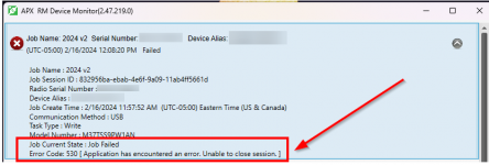

Has anyone seen this error before? I cant seem to find much about it. Only seems to pop up when doing a firmware update, other updates seems to be working fine.
Codeplug: 31.00.01
Firmware: 30.04
