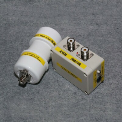

A YouLoop will work with a receiver like AirSpy HF+ Discovery having high gain but will not be satisfactory with many receivers. An active E-field antenna off eBay may be his best choice as enexpensive if he can mount it outside away from noise sources. I have personally tested many there and the one below was the best.
