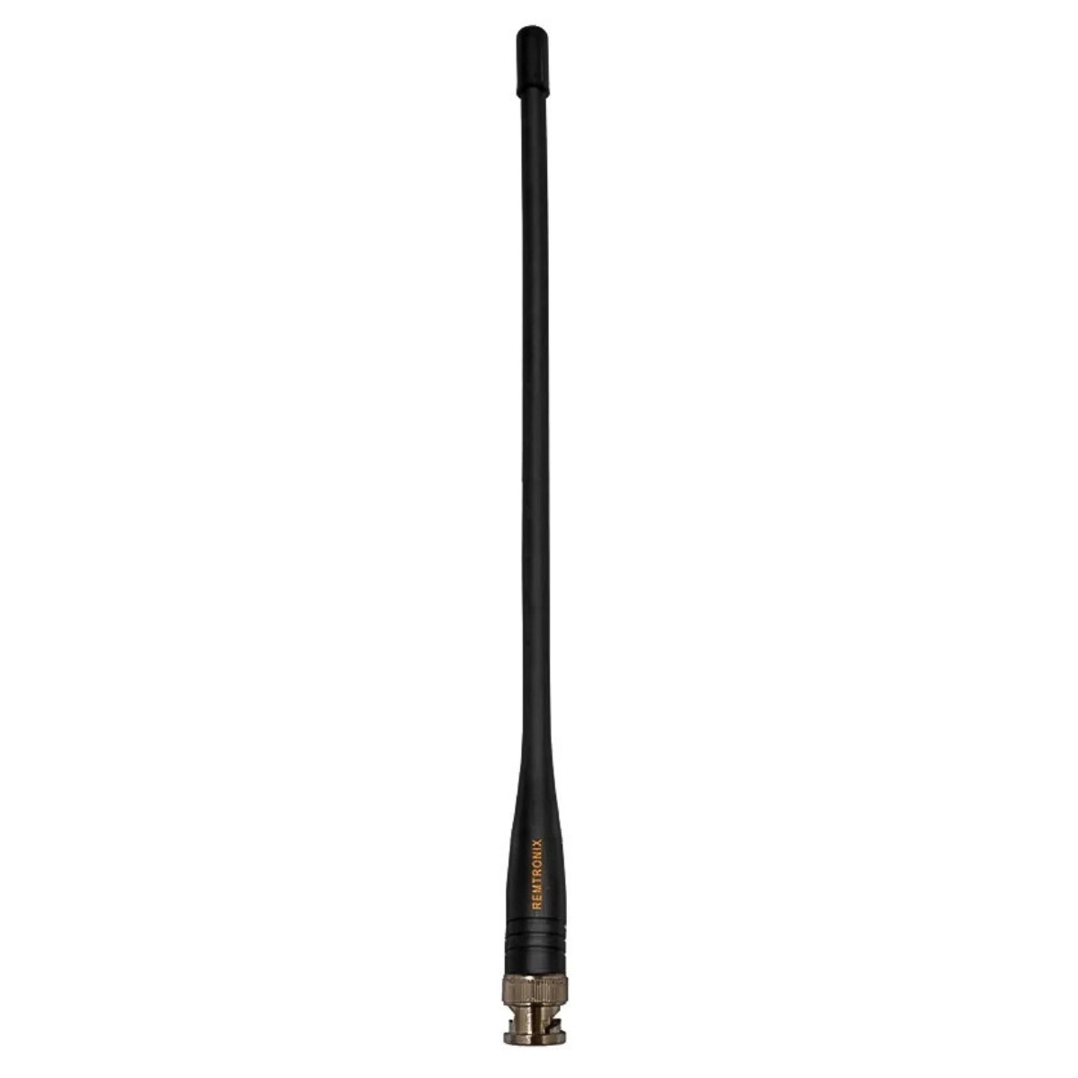

Not really, unless you’re looking for UHF and above only. If so, the Remtronix REM-920B would work; it‘s a tad longer than a stock antenna. Works fairly well for VHF on strong signals.
