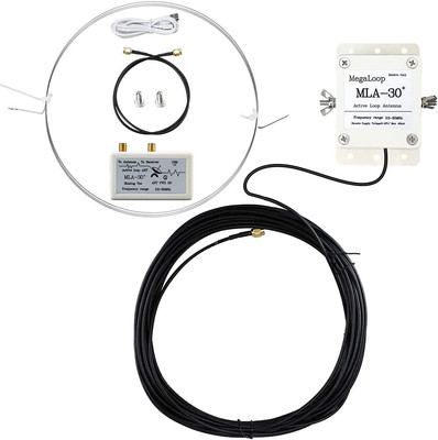

Personally I'd stay away from loop amps that don't have a gain control. Putting it on a PL660 would introduce the possibility of overloading.
These 2 are at opposite ends of the cost spectrum. From our loops wiki

If you're a tinkerer and have the parts, you can build your own YouLoop and add an amp. I *think* the LZ1AQ design has a way to cut the gain down - there are a few pots on the circuit board that I see on the website (someone can verify this). The links for the YouLoop and the LZ1AQ amp can be found on our loops wiki...
You don't need to DIY.
..or..

Yes you're right, but you would still be ahead if you bought the amp kit and built the antenna yourself. To each their own.
In any case, there' an issue with the raw gain coming out of the amp. It might be too much for a little Tecsun portable to handle. Overloading and noise issues would be an issue in this case. All the examples I found have gain controls which would mitigate that issue to some degree.
