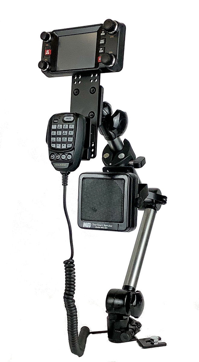

“ . . Not sure where you plan to put your 578.”
Looking handy:
Looking handy:
I am using the same type of mount, although maybe not the same manufacturer. It attaches to the passenger seat floor bolt with a post that elevates the radio up and slightly over the center console. It does a good job with little or no vibration… the only thing I find wrong with the way I have configured the mount is it gets in the way of the console’s optional fold-over writing surface. The shift lever folds down and out of the way of the writing surface. But I’m left handed so I never use the option anyway! Thanks for the input.
