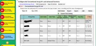

To the best of my knowledge, I'm following the steps to add the wildcard "FFFF" Mdc1200 protocol for decoding using PPS 4.0.41 on my Unication G3 (and G5) but I'm receiving an error.
  1. I've entered the MDC1200 protocol (and alias) under tab E4 and named it MDC1200
  2. I created a Conventional Group under tab E6 and entered FFFF under the MDC/DVOA tg setting
  3. I selected a Ch / Knob position under E7, selected my frequency, placed it under Monitor Mode and selected the MDC1200 protocol
I keep getting the exclamation point (!) error at the bottom when it says to select something from the TGID Grouping box. The dropdown is empty and there's nothing to choose from, thereby prohibiting me from saving the changes to that knob. Am I missing something ?

Did you also setup a TGID Group in E6.2? That is what the PPS is looking for you to add.

I believe I did it correctly :unsure:
