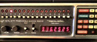

Thanks for checking that for me! It’s amazing how they assembled these with all of that fine wiring yet they work so well. Mine never stores the memory even when plugged in. When it’s switched on every channel is 316.2525 mhz. Why? I don’t have an answer for this. Can’t find many discussions or videos on this model maybe because of its age. Lots of information on the Pro-2006 of which I own 2 of them both with the infamous backlight problem
